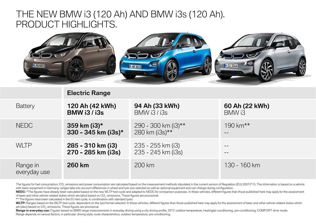

  1. Salut, Tot urmaresc sa cumpar un BMW i3 si am ajuns la concluzia ca din 2018 ar fi cel mai putin riscant , ca s-au facut ceva imbunatatiri bazate pe problemele modelelor anterioare. Am gasit unul (VIN WBY7Z41090VD81989) la un dealer in Romania insa e cam departe de mine sa il vad si ei nu au putut sa imi ofere nici un fel de detalii(doar ca ar avea 42000 km...) despre: 1.are apple carplay/android auto? 2.ce tip rulmenti motor ( sa fie taper roller bearings)? 3.stare si model compresor aer condiționat (It doesn't matter what year or Rex or Bev, the newest compressor is recommended for all i3s. Compressor - BMW (64-52-9-496-107)... there have been six different p/n's for the i3 aircon compressor) 4.daca a fost implicat in "recall pentru additional cap for rex engine ventilation line (ventilation line may rub against positive cable)" https://www.google.com/url?sa=t&rct=j&q=&esrc=s&source=web&cd=&ved=2ahUKEwiXuKfKzJqJAxX61gIHHQ0BCFYQFnoECBIQAQ&url=https%3A%2F%2Fstatic.nhtsa.gov%2Fodi%2Frcl%2F2017%2FRCRIT-17V088-6492.pdf&usg=AOvVaw2JFP_5hIU2izAzQZ-uGce3&opi=89978449 5.Late in the 2017 model year, BMW switched over to the newer version drivetrain, including revised EME (inverter), Drive Motor (new bearings design), KLE (now contains all charging electronics, instead of half being in the EME), and the eDME. The inverter now (late 2017 onward) performs the traction control and Regenerative braking FUNCTIONS natively, resulting in much faster traction control response. The key to know which 2017's are so equipped is the VIN, characters 4, 5, and 6 - which must be (drum. roll...) "7Z2" for the BEV "7Z4" for the REx Deci teoretic dupa cele 3 caractere din VIN ar fi ok dar cum pot sti sigur codurile componentelor care se afla efectiv pe masina? ca poate a fost penurie de ceva componente si au folosit ce aveau pe stoc (cum a fost cu ecranul care e vizibil). RCRIT-17V088-6492-compressed.pdf
