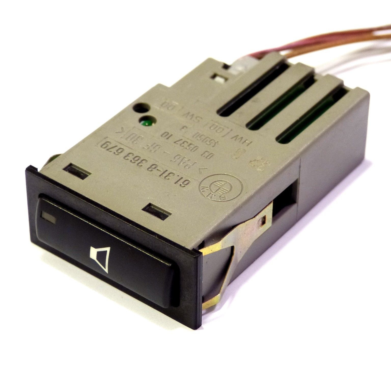

  8. Cumpar buton individual HK Harman Kardon part number: 61 31 8 363 679
