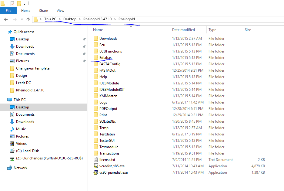

Unde configurez portul com1 in Rheingold? Cam asa arata fisierul de configurare ediabas.ini: ################# ;# EDIABAS 7.3.0 # ;################# ;============================================================================= [Configuration] ;============================================================================= Interface = STD:OBD Simulation = 0 EcuPath = C:\EDIABAS\ECU SimulationPath = C:\EDIABAS\SIM TracePath = C:\Windows\Temp TraceSize = 1024 ApiTrace = 0 IfhTrace = 0 ; IfhnTrace = 0 ; SystemTraceSys = 0 ; SystemTraceBip = 0 ; SystemTraceIfh = 0 ; SystemTraceNet = 0 ; BipDebugLevel = 0 ; BipErrorLevel = 0 UbattHandling = 0 IgnitionHandling = 0 ClampHandling = 0 RetryComm = 1 SystemResults = 1 TaskPriority = 0 ; CodeMapping = C:\EDIABAS\BIN\ansi2oem.tab ; LoadWin32 = 0 NetworkProtocol = TCP ; --- neu ab EDIABAS 7.2.0 --------------------------------------------------- ShowIcon = 0 LogLevel = 0 TraceBuffering = 0 TraceHistory = 0 TraceSync = 1 ; TraceWriter = <FilePathName> ;============================================================================= [TCP] ;============================================================================= RemoteHost = LMUC203404 Port = 6801 TimeoutConnect = 2000 TimeoutReceive = 2000 TimeoutFunction = 10000 ; TimeResponsePending = 5000 ; DisconnectOnApiEnd = 1 ; InitCmd0 = FE,04,00,03,01 ; InitCmd1 = FD,05,00,03,01 ;============================================================================= [XEthernet] ;============================================================================= RemoteHost = Autodetect HeaderFormat = 0 TesterAddress = F4,F5 ControlPort = 6811 DiagnosticPort = 6801 TimeoutConnect = 20000 ;============================================================================= [ifhProxy] ;============================================================================= Port = 6700 ;============================================================================= ; End Of File EDIABAS.ini ;============================================================================= Alta chestie: Calea catre EDIABAS\ECU este alta : EcuPath = C:\EDIABAS\ECU SimulationPath = C:\EDIABAS\SIM TracePath = C:\Windows\Temp Desi in folderul Rheingold este instalat Ediabasul, trebuie sa mai instalez alt ediabas in C:\ ? Multumesc
Adaptor pentru Rheingold
Am cablu odb luat cu inpa care are k-dcan.. dar nu vrea sa se conecteze la el.. trebuie neaparat pe com9 sau com1?
