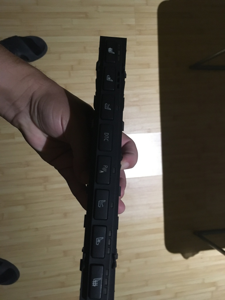

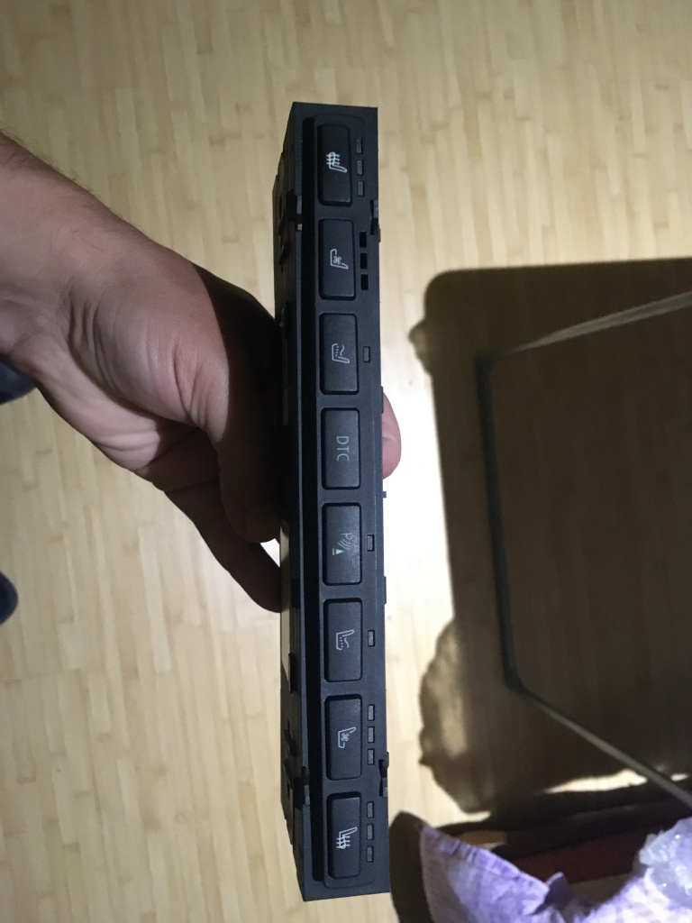

  1. ; ; Vand bagheta butoane incalzire, ventilare, masaj, DTC, PDC si coloana electrica volan, modul SZM 9155294 BMW E60/61, pret 800RON
