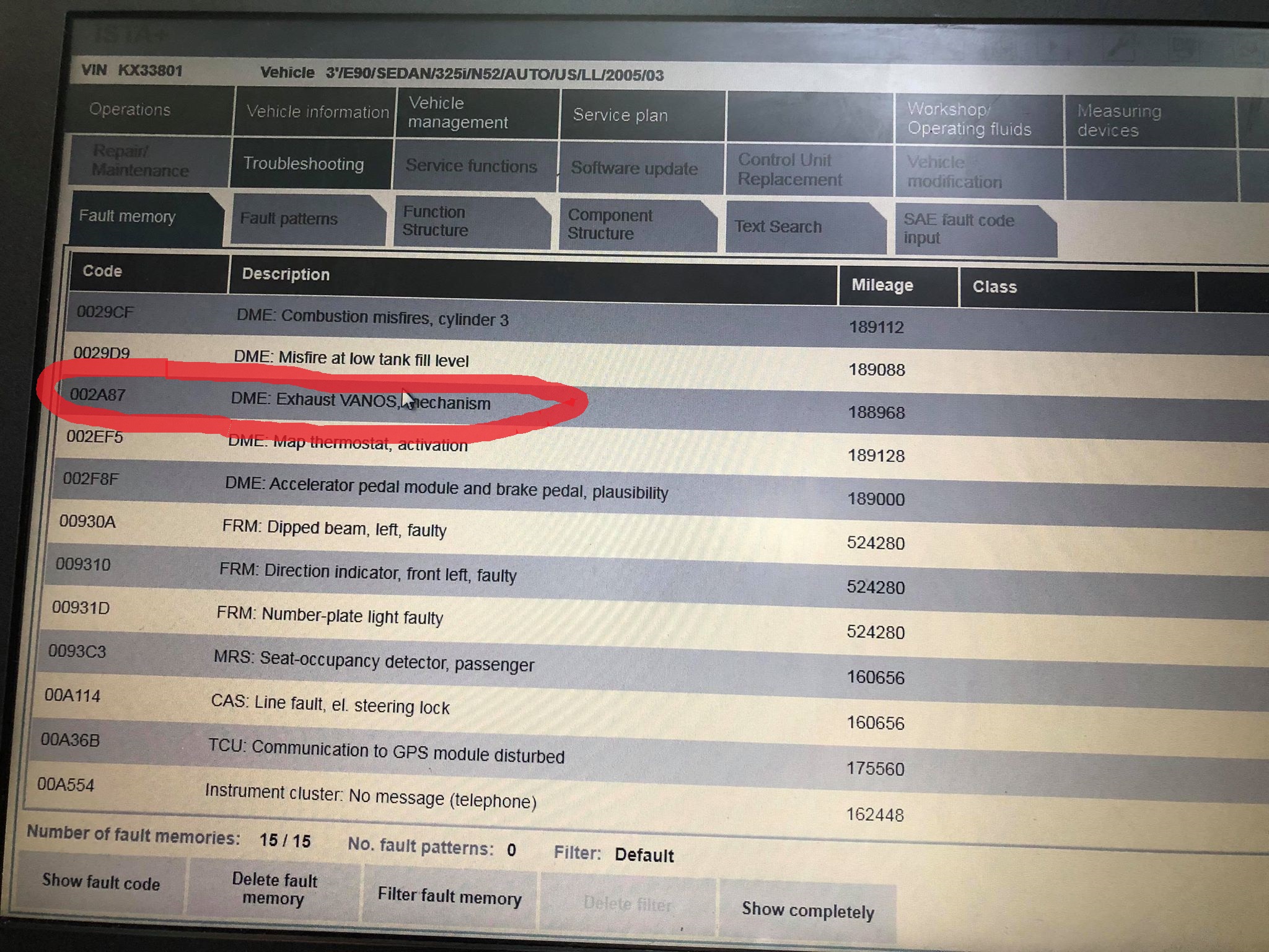

Probleme N52B30 - Exhaust VANOS mechanism
trebuie sa inlocuiesti solenoidul de la exhaust vanos ... o sa se blocheze in curand probabil si eroarea o sa se transforme in VANOS exhaust – stiff; jammed mechanically + check engine in bord + limp mode
ideal este sa ii schimbi pereche ( intake / exhaust )
Symptoms of a Bad BMW VANOS System
Loss of power and torque, primarily in the lower ranges, typically below 3k RPMS
Engine hesitation and bogging in the lower rpm ranges
Rough idle with frequent hiccups
Increased fuel consumption or poor fuel economy
Cold start issues and stalling in cold weather
Engine fault codes, aka a check engine light
Engine constantly falls into limp mode after acceleration
Codul piesei - 11367585425 - aprox 680 ron
