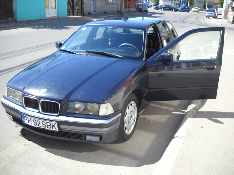

Gata am facut poze. Am uitat sa adaug, in urma cu 1luna si putin, au fost schimbate amortizoarele, bucsele, frane, directie, geometrie etc. Mai am cateva poze, dar mi-a dat erroare "www.bmwclub.ro Driver Error", asa ca le-am uploadat pe un site. http://i220.photobucket.com/albums/dd37/m_shobby/DSCN2564.jpg http://i220.photobucket.com/albums/dd37/m_shobby/DSCN2563.jpg http://i220.photobucket.com/albums/dd37/m_shobby/DSCN2562.jpg http://i220.photobucket.com/albums/dd37/m_shobby/DSCN2561.jpg http://i220.photobucket.com/albums/dd37/m_shobby/DSCN2560.jpg http://i220.photobucket.com/albums/dd37/m_shobby/DSCN2559.jpg http://i220.photobucket.com/albums/dd37/m_shobby/DSCN2558.jpg http://i220.photobucket.com/albums/dd37/m_shobby/DSCN2555.jpg http://i220.photobucket.com/albums/dd37/m_shobby/DSCN2554.jpg http://i220.photobucket.com/albums/dd37/m_shobby/DSCN2550.jpg http://i220.photobucket.com/albums/dd37/m_shobby/DSCN2552.jpg http://i220.photobucket.com/albums/dd37/m_shobby/DSCN2541.jpg http://i220.photobucket.com/albums/dd37/m_shobby/DSCN2542.jpg http://i220.photobucket.com/albums/dd37/m_shobby/DSCN2543.jpg http://i220.photobucket.com/albums/dd37/m_shobby/DSCN2544.jpg http://i220.photobucket.com/albums/dd37/m_shobby/DSCN2547.jpg http://i220.photobucket.com/albums/dd37/m_shobby/DSCN2548.jpg http://i220.photobucket.com/albums/dd37/m_shobby/DSCN2549.jpg http://i220.photobucket.com/albums/dd37/m_shobby/DSCN2532.jpg http://i220.photobucket.com/albums/dd37/m_shobby/DSCN2533.jpg http://i220.photobucket.com/albums/dd37/m_shobby/DSCN2535.jpg http://i220.photobucket.com/albums/dd37/m_shobby/DSCN2536.jpg http://i220.photobucket.com/albums/dd37/m_shobby/DSCN2538.jpg http://i220.photobucket.com/albums/dd37/m_shobby/DSCN2539.jpg Multumesc
Vand BMW E36 318TDS Touring, fabricatie 12.1995 - 1665cmc, 100CP; - kilometraj aprox 263.000; - oglinzi electrice; - inchidere centralizata; - alarma; - angel-eyes; - aer conditionat; - cd player cu intrare USB, card microSD, etc.; - Servo, ABS; - tapiterie material textil; Masina este inmatriculata. Revizie tehnica in 16.02.2012. Pret: 3100e neg Schimb cu BMW e36 316 coupe '95-96. ___________________________________ Masina a avut mici puncte de rugina gen, praguri si cateva la capota, azi le-am rezolva, urmeaza sa pun angel-eyesurile. Si mai am de schimbat ceasurile deoarece nu imi indica corect litrometrul, ceasurile le am in porbagaj trebuie sa imi gasesc o zi intreaga sa rezolv. Cat despre consum pot zice ca este pentru "gospodari" masina, consuma putin, probabil ca si este destul de reglata, filtre tot la zi. Pentru mai multe intrebari pot raspunde. Voi reveni cu mai multe poze imediat ce reusesc sa le fac. Multumesc
