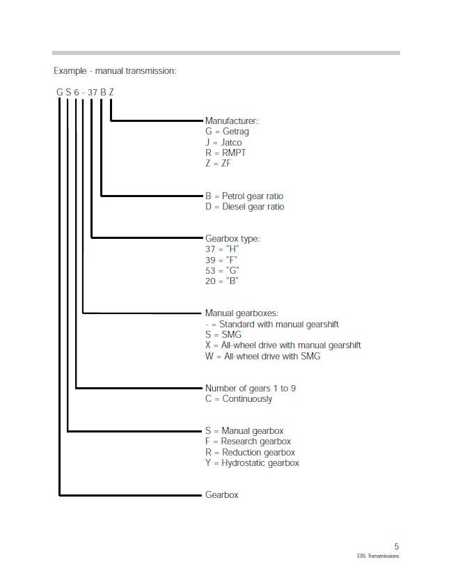

am cutie GS6-17BG, a fost montata si pe 320i, 525i, 528i 335i,120i, 128i

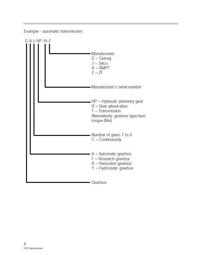

According to BMW TIS, it seems like the transmissions are different indeed:
Designation is as follows:
G = transmission
S = manual
6 = 6 forward gears
17 = I-transmission, 37 = H-transmission, 53 = G-transmission
B = petrol/gasoline gear ratio
Z = manufacturer is ZF, G = manufacturer is Getrag
