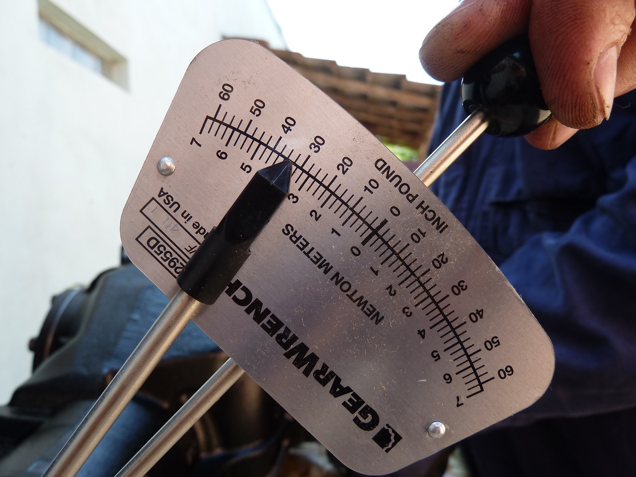

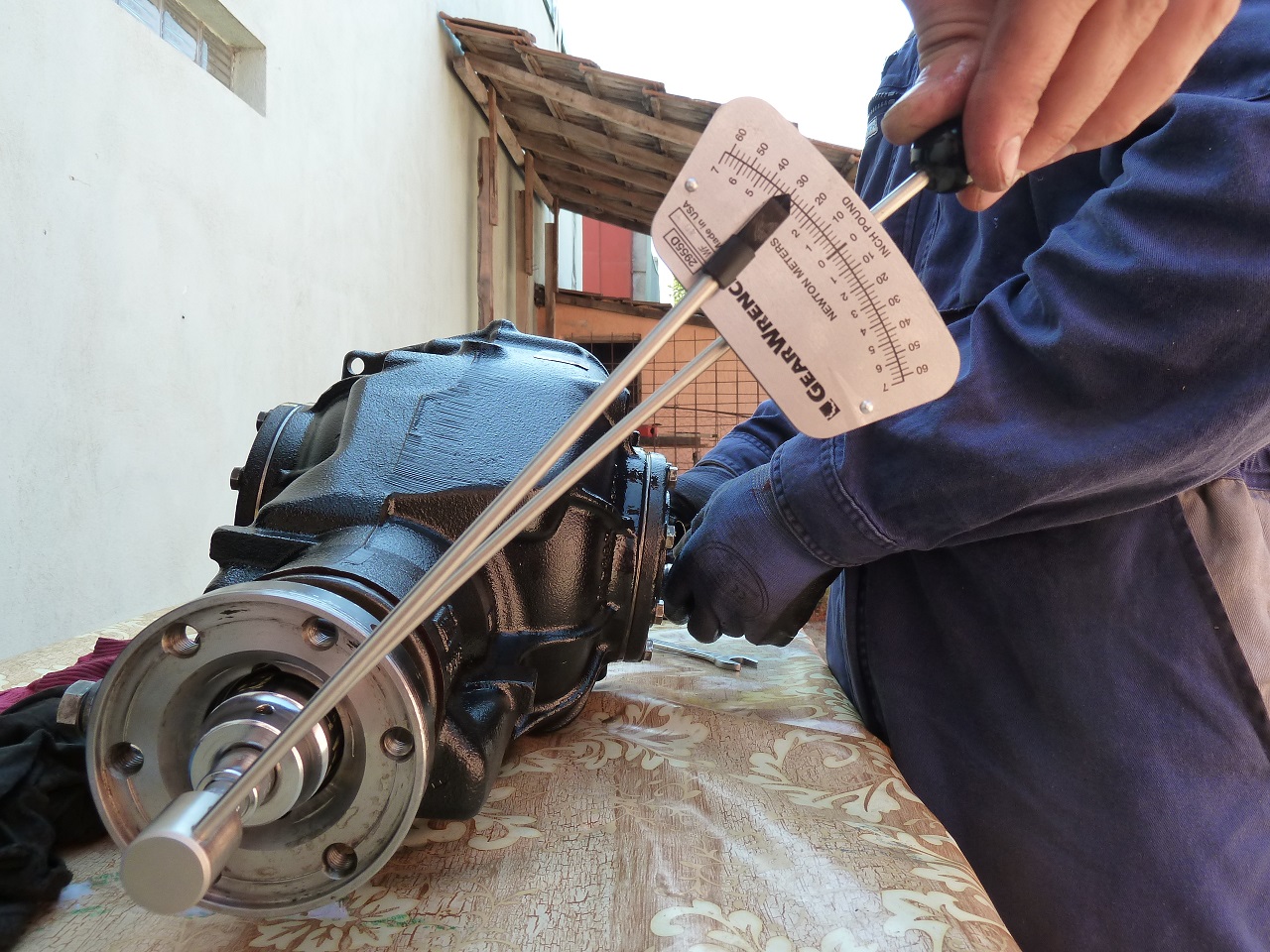

Checking Pinion Gear Torque (Limited Slip Differentials) - With differential carrier assembled, install axle flanges in carrier. Clamp one flange in vise and using and INCH pound torque wrench (Type 1), or foot pound torque wrench (Type 2), turn other flange. If rotating torque of side and pinion gears i not to specification, install thicker or thinner case cover-to-clutch assembly thrust washers.
http://1.bp.blogspot.com/-UAF5trEM_Ls/T2iKr3OgOkI/AAAAAAAABkE/9JLDbDW-M0k/s400/1975_bmw_pinion_gear_limited_slip_differential.JPG
daca vrei sa masori preload-ul la sateliti poti folosi o cheie dinamometrica normala si 2 capete de planetara
http://www.google.de/imgres?biw=1600&bih=809&tbm=isch&tbnid=7ee540Bs-orv4M%3A&imgrefurl=http%3A%2F%2Fautomotiverepairguides.blogspot.com%2F2013%2F07%2Fbmw-1975-76-drive-axles-split-housing.html&docid=6UqkNZxhjndeaM&imgurl=http%3A%2F%2F3.bp.blogspot.com%2F-PuBtsT5kdAg%2FT2ig_5OGK7I%2FAAAAAAAABkk%2FG8f1aFqK3Mo%2Fs400%2F1975_bmw_ring_gear_backlash2.JPG&w=237&h=182&ei=c1X-UvWmOOH-ygPP1YH4Bw&zoom=1&iact=rc&dur=1819&page=1&start=0&ndsp=28&ved=0CH8QrQMwDg
  • Author
Intradevar buna ideea, insa la pinion ma intereseaza prima oara. Nu scap fara sa cumpar acea cheie speciala.
este cam acelasi lucru cred, asamblezi diferentialul in carcasa si te cuplezi cu cheia la cupla pentru cardan, pui 7nm sau cat ai tu specificatii si invarti la mana 360grd usor , daca sare cheia este prea strans
la fel si in poza aceea, este foarte important sa verifici daca cupleaza egal stanga-dreapta si nu este decalibrat, inauntru sunt niste saibe care se decalibreaza se ovalizeaza si blocheaza - cupleaza satelitii prea devreme , de aceea apar trosniturile in viraje si miros de incins in lsd
totusi daca vrei sa faci totul ca la carte succes :thumbsup:

Multumesc frumos, insa ceas comparator si stativ magnetic am, sunt noi noute. M ar fi interesat acea cheie dinamometrica ce masoara prelod-ul.
  • Author
Am cumparat cheia speciala de masurat pre-lodul la diferential. In curand ne apucam de treaba.

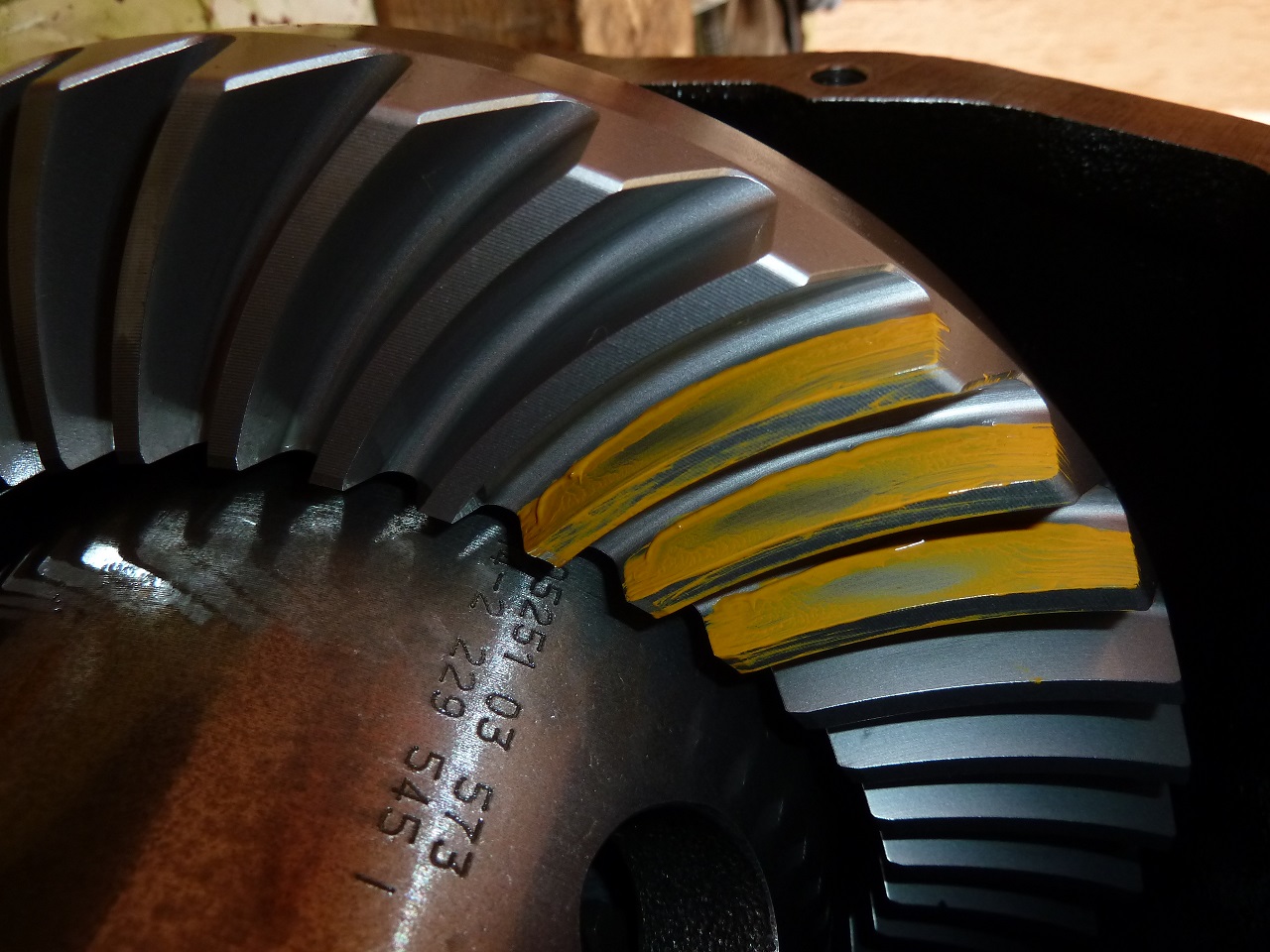

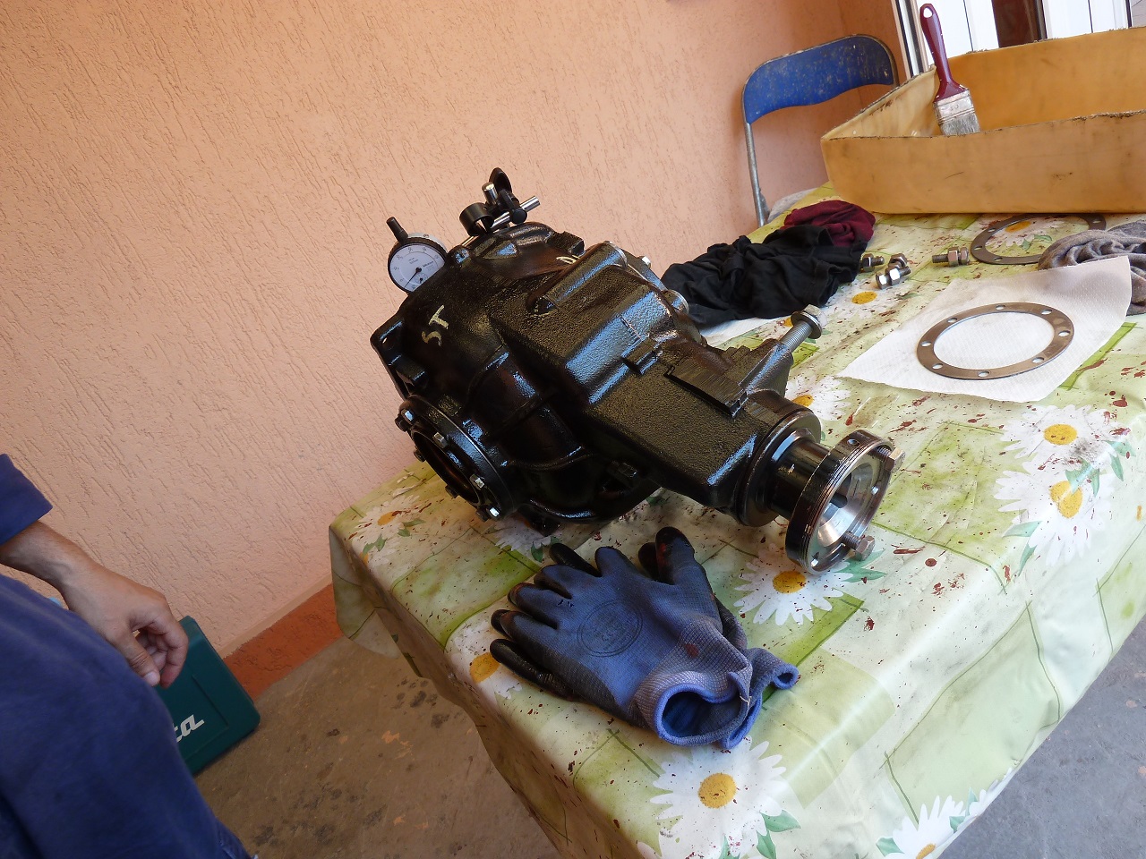

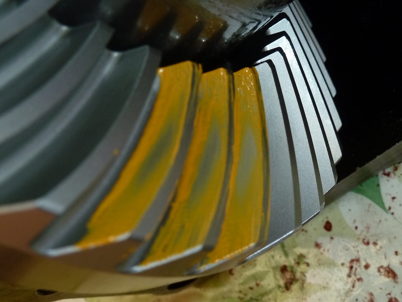

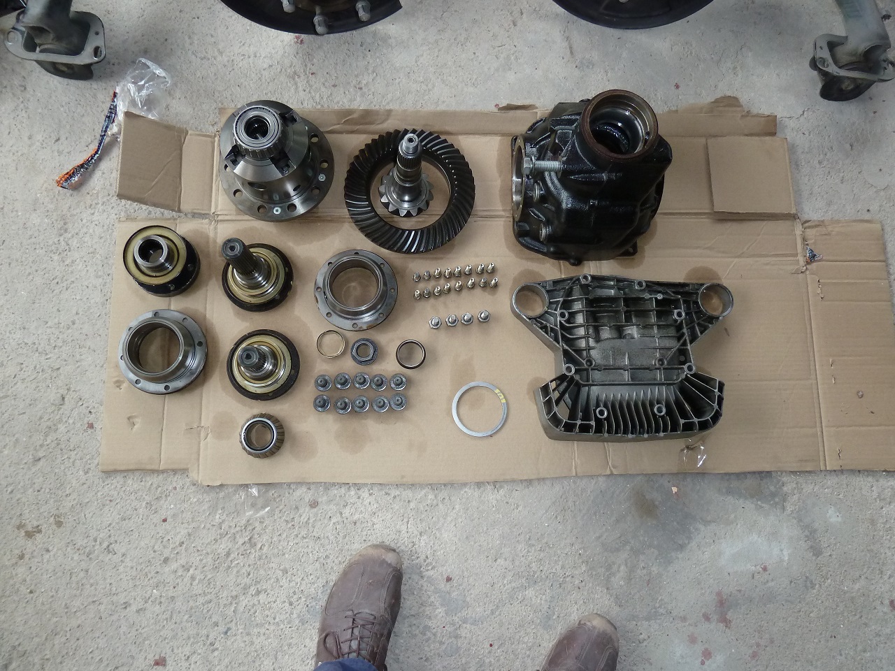

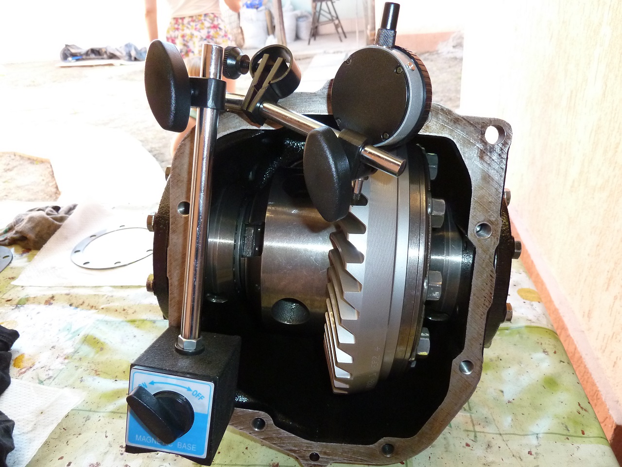

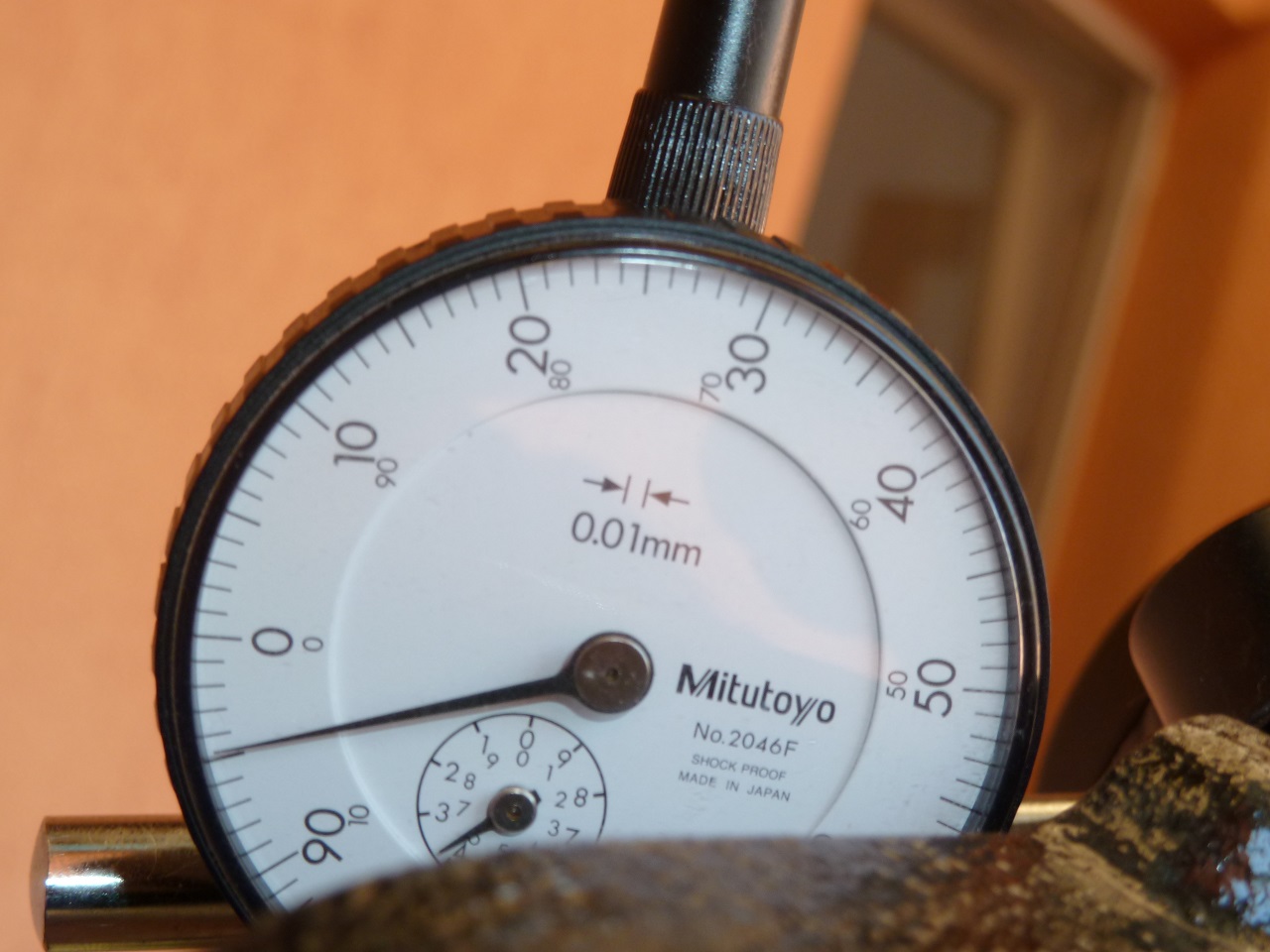

Dupa mult stres si munca am reusit sa montez noul raport 4.44 .Nu am gasit niste specificatii clare in legatura cu specificatiile pt. diferentialul meu, motiv pt care am masurat tot ce am demontat la diferential, in felul asta am avut referinta masuratorile mele. Jocul dintre pinion si coroana a fost 5 sutimi iar forta la rostogolire(prelod)30inch pound(cheia folosita masoara in inch pound). Am verificat si amprenta,totul este in regula. Dupa ce o sa pun diferentialul pe masina o sa revin cu noi informatii.
Nu am poze cu acea cheie speciala care masoara forta de rostogolire(prelod). Daca vrea cineva sa vada cum am masurat preloud-ul o sa fac poze.
Am uitat sa mentionez faptul ca nu s-au potrivit distantierele originale pt a regla jocul intre pinion si coroana. A trebuit sa confectionez altele.
Foarte bine ca ai rezolvat, ti-am spus paca ca preload.ul il faci cu cheia dinamometrica, transformi inch-pound in Nm si invarti la mana
  • Author
Nu stiu daca poti sa reglezi prelod-ul cu o cheie dinamometrica obisnuita. In toate filmuletele urmarite de mine folosesc cheia pe care am folosit-o si eu.
Reglezi la 5Nm de ex cheia si invarti la mana
360 grade usor si continuu 0.5-1 rot/sec, daca preloadul depĂŁseste valoarea setatĂŁ pe cheie sare siguranta
  • Author
360 grade usor si continuu 0.5-1 rot/sec, daca preloadul depăseste valoarea setată pe cheie sare siguranta
Intradevar nu este o idee rea, insa nu cred ca ar fi fost la fel de precisa masuratoarea. Am vrut sa fac totul ca la carte, am folosit ceas comparator, pasta speciala pt verificat amprenta + cheia de masurat prelod. Pe cine am mai intrebat mi a spus ca face jocul la mana, amprenta o verifica cu vopsea obisnuita. Am pus buxa de strivire noua(majoritatea folosesc buxa veche), simeringuri noi,siguranta de la piulita noua. Dupa cum am spus am vrut sa fie totul ca la carte.
