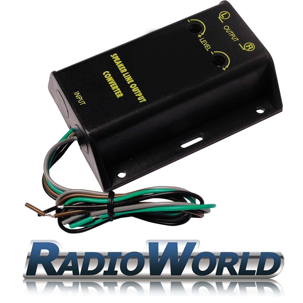

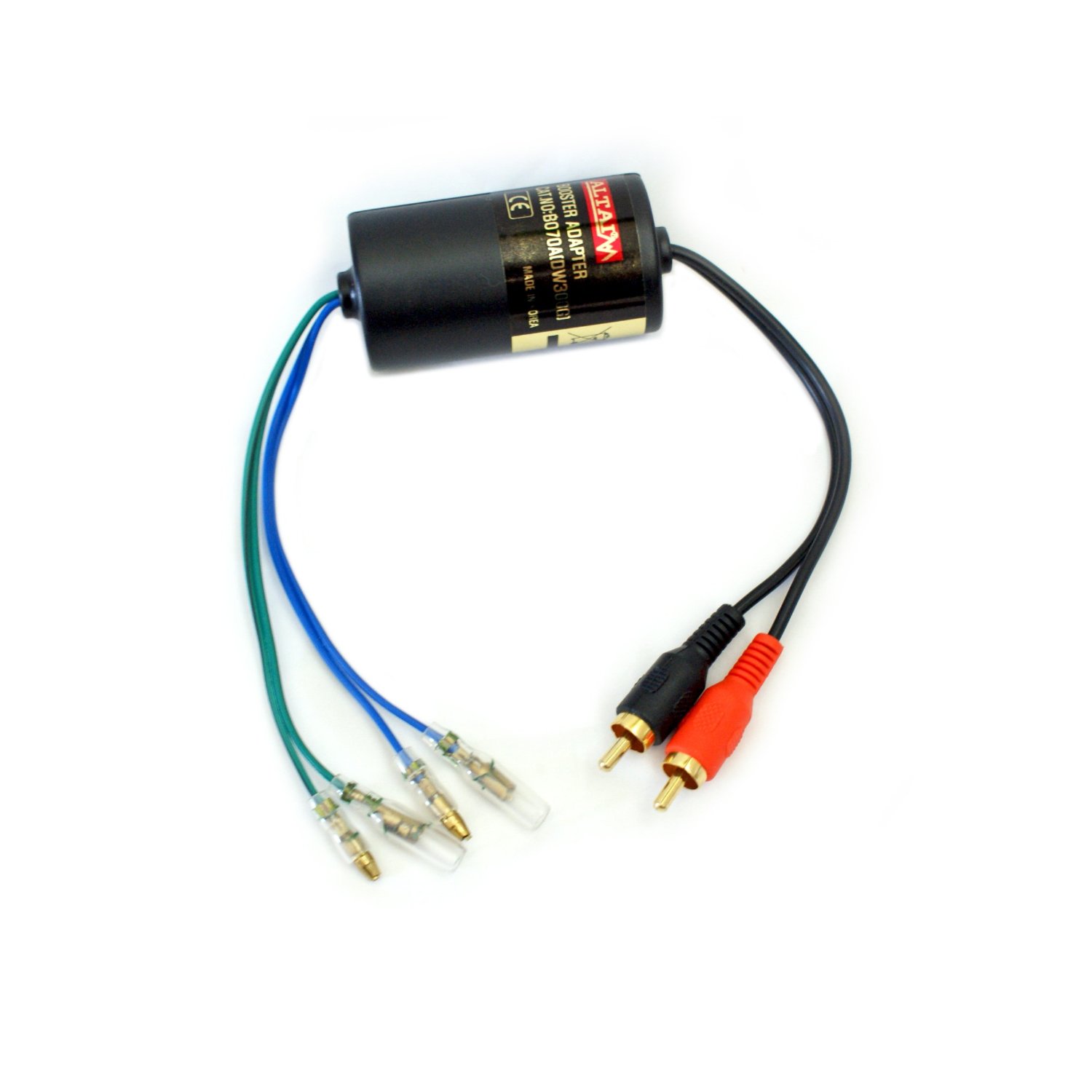

  20. Se poate lega acest adaptor direct la boxe? poate primi semnalul audio numai din boxele spate? sau trebuie legate cele de pe usi? Ma gandeam sa leg doua fire la difuzorul din dreapta si doua la cel din stanga (difuzoarele de sub luneta).

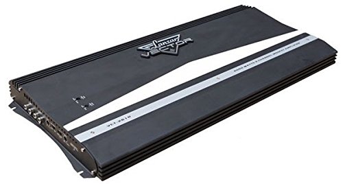

  21. Pana la urma am ales aceste componente: 1. Lanzar VCT2610 6000W 2 Channel High Power Mosfet Amplifier RMS Power @4 Ohms 300 watts x2 THD @4 Ohms 450 watts x2 RMS Power @2 Ohms 600 watts x2 THD @2 Ohms 900 watts x2 Maximum Power Output @2 Ohm 6,000 watts x1 Bridged Power @4ohm 8,000 watts x1 Low Level Impendance Input: 10K Ohms Low Level Sensitivity Input: 200mV-6V Adjustable S/N Ratio: 95dB Channel Separation: 65dB Chrossover Filters- Low Pass:40 Hz-150 Hz High Pass:40 Hz-250 Hz Bass Boost: 0~+18dB Sub Sonic Filter:10-100 Hz Stereo Mode: 2-4 Ohms Bridged Mode: 4-8 Ohms Fuse Size: 60A x2 Power Supply Voltage: 14.4V DC Neg. Ground (10.5-16V) 2. JBL GT5-2402BR Dual 12 Inch Subwoofer Type Enclosed Bass-Reflex Subwoofer Low-Frequency Transducer Two 12" (300mm) Polypropylene cones Voice Coil 2" (51mm) diameter Power Handling, RMS 550 W Power Handling, Peak 1600 W Frequency Response 40Hz–200Hz Nominal Impedance 2 ohms Sensitivity (2.83V @1m) 95 dB Enclosure Type Bass-reflex, with Slipstream port Imi puteti spune daca am facut alegerea corecta si daca amplificatorul este ok, sau prea puternic pentru tubul de bass care are 550w RMS? Nu as vrea sa distrug/ard subwoofer-ul...

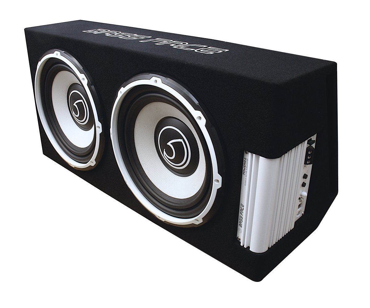

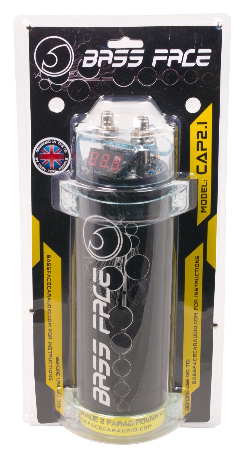

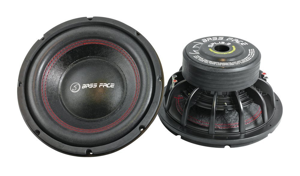

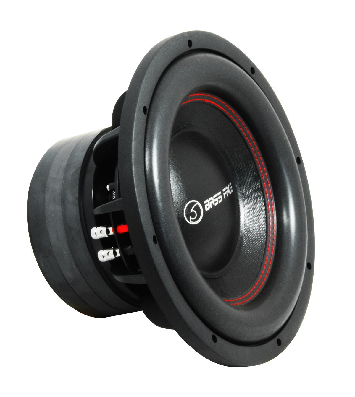

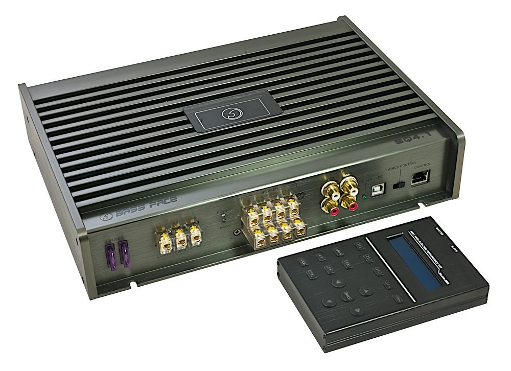

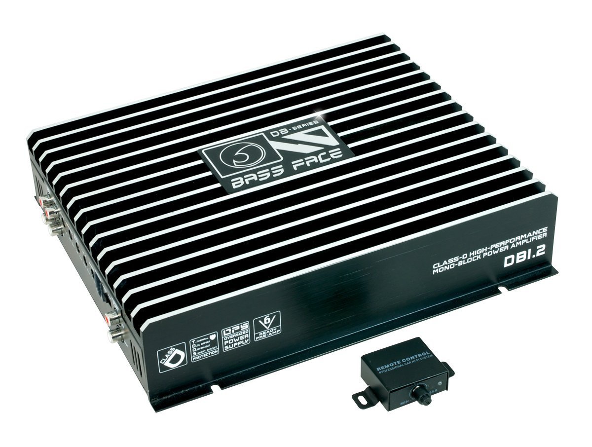

  22. Salutare. Am de ales un amplificator, subwoofer sau difuzor + carcasa, capacitor, cabluri si convertor RCA. Am de ales intre acestea: 1. Bass Face POWER12.2 2600W 12 inch Active Twin Subwoofer 2. Bass Face SPL12.3 5000 W 12-Inch (2500W RMS) 3. Bass Face SQ4.1 2000W 4 Channel Amplifier With Digital Signal Processing 4. Bass Face DB1.2 2500W Class-D Monoblock Subwoofer Amplifier 5. Bass Face SPL12.2 2500W 12 inch Dual Voice Coil (1250W RMS) 6. Speaker to RCA Converter 7. Bass Face CAP2.1 2 12V Farad Merita sa iau acel Twin Subwoofer si nu amplificator separat cu unul din acele difuzoare? Eu vreau un bass sanatos si clar pe masina.
