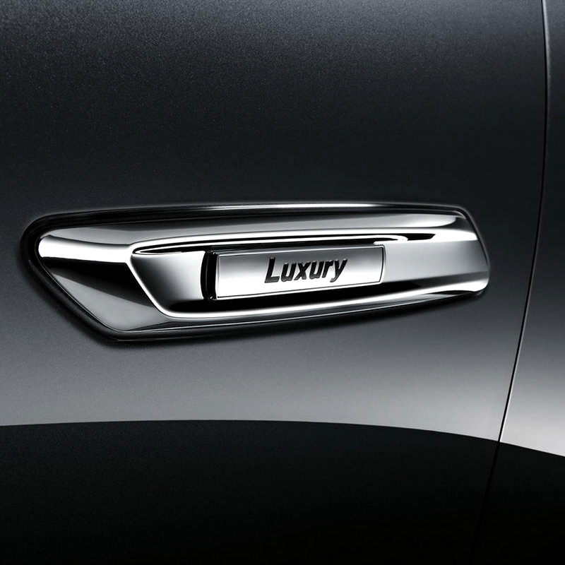

  24. Cumpar emblema / ornament aripa dreapta fata F10 luxury
