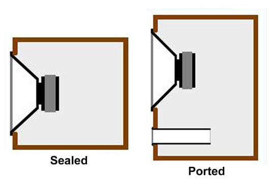

O completare pentru @MCO
Incinta sealed (stanga) vs incinta ported (dreapta)
http://www.audioholics.com/education/loudspeaker-basics/sealed-vs-ported/image
