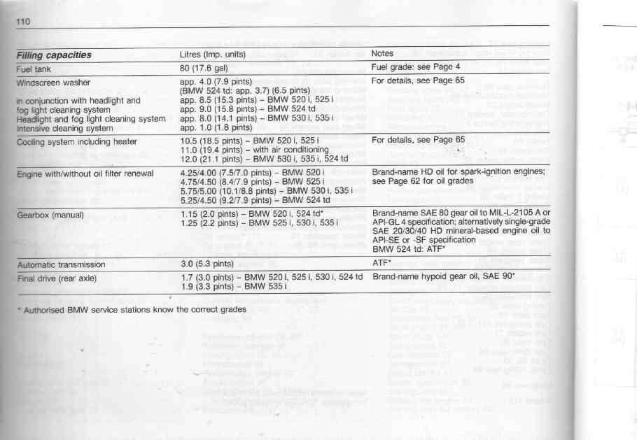

2. referitor la cat ulei intra in cutie....vezi atasamentul...3 litri in cutie si 1.7litri in diferential
