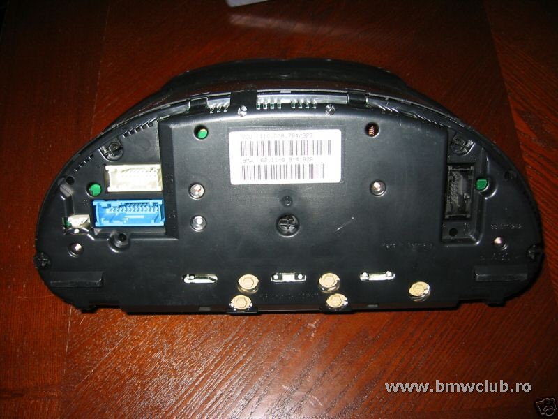

  5. pai ma bazez pe cunostintele de la servici :) avand in vedere ca lucrez cu ECU-uri de masina cel putin 10 ore pe zi ce priveste timp de stand by m-am referit la: la cat timp de la inchiderea masinii e va intra in stand by pot sa iti dau un exemplu concret daca vrei clusterul de la e39 dupa KL 15 OFF 15 secunde consuma 250 ma iar dupa 15 s consumul scade la 1 ma char sub la unele clustere low line (sunt cele cu mai putine functii) cum exista un stand by exista si un wakeup in masina deoarece vb de CAN care are si el timpii lui s.a.m.d :)

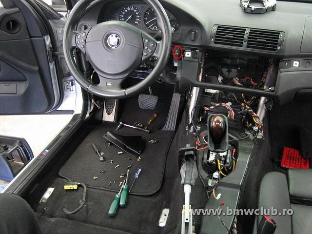

  14. unde ii incercuit ai surub fara al desface pe acela si de cealalta parte a volanului nu ai cum sa dai jos masca dar mai inati trebe sa dai jos ornamentele
  15. sunt in gauri nu trebe desfacut nimica o surubelnita iti trebuie sau o tubulara mica :blink:

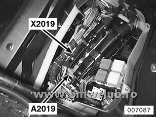

  16. http://www.carsoft.ru/avtorepair/bmw_e34/6450.0/index.html sau :blink: A2019 DDE control unit Plug connector overview Number X-pin, colour Description X2019 55-pin, Black Plug connector DDE control unit Pin assignments at plug connector X2019 Pin Type Description / Signal type Connection / Measuring notes 1 E Signal Signal, fuel quantity control unit Injection pump 2 E Signal, fuel quantity control unit Injection pump 3 E Signal Electrical cutout Electrical cutout 4 E Signal Warning lamp preheating/error signal Light module Instrument cluster 5 A Needle movement sensor (injection time) SD nozzle 6 E Pressure converter AGR Changeover valve for exhaust gas recirculation (AGR) 7 Not used 8 E Preheater time control Glow plug relay 9 E Engine mount damping control Electrical changeover valve, engine mount 10 E Injection timing control Timed valve 11 A Ready indication signal, driving speed Instrument cluster 12 E Ground Needle movement sensor (injection time) SD nozzle 13 E Sensor ground Ground connector 14 E Centre pick-off control path sensor Injection pump 15 E Activation DDE relay DDE relay 16 E Voltage supply, terminal 30 for throttle actuator Fuse carrier, engine electronics Fuse F1 DDE 17 E Voltage supply, terminal 30 for throttle actuator Fuse carrier, engine electronics Fuse F1 DDE 18 E Ground Ground connector 19 E Ground Ground connector 20 Not used 21 A Reference coil control path sensor Injection pump 22 A Not used 23 A A/C compressor signal Heating and A/C control module 24 E Signal, A/C compressor relay Heating and A/C control module 25 A Idle switch Pedal position sensor 26 E Brake light signal Brake light switch 27 Not used 28 A Clutch signal Clutch switch 29 E Speed signal Connector for rear right wheel speed 30 Not used 31 A Brake light test signal Brake light switch 32 E/A FGR data link Multifunction steering wheel control unit 33 A Supply Pedal position sensor 34 A Supply Hot-film air mass meter 35 A Fuel temperature Injection pump 36 A Oil temperature signal Oil temperature sensor 37 E Signal Pedal position sensor Pedal position sensor 38 E Signal, hot film air mass meter Hot-film air mass meter 39 A Measurement coil, control path sensor Injection pump 40 E/A CAN bus low CAN bus low 41 E Error signal, glow plug relay Glow plug relay 42 E/A Communication link diagnosis TXD Connector TXD 43 E/A CAN bus high CAN bus high 44 E Switching signal A/C standby Heating and A/C control module 45 E Antitheft alarm system signal (EWS) Electronic immobilizer control unit (EWS) 46 E Presupply pump relay Fuel pump relay 1 47 A Speed signal Speed (rpm) sensor 48 Not used 49 A Signal Fuel consumption indicator Integrated electronic control unit (IKE) Instrument cluster 50 A TD signal (engine speed) Integrated electronic control unit (IKE) Instrument cluster 51 A Supply for boost pressure sensor Boost pressure sensor 52 Not used 53 A Coolant temperature Dual temperature sensor 54 E Signal Boost pressure sensor Boost pressure sensor 55 E Terminal 15 Fuse F14
