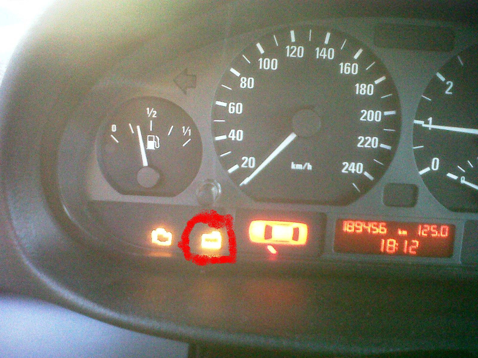

Intre timp imi apare asta in bord. Ce e? post-53295-0-74461600-1349366987_thumb.jpg
antigel sub limita minima
