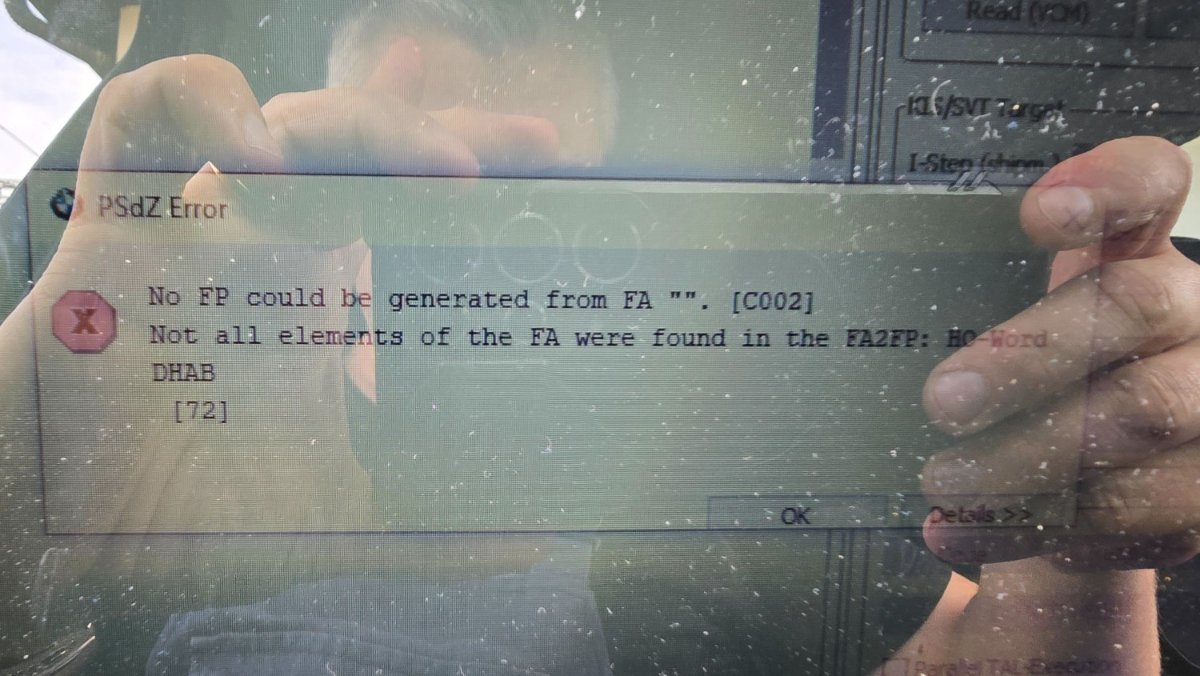

33587.thumb.jpg.4ca908e5095226b2e12e7ee4f0a7a835.jpgYes I know that it's easy but e-sys keeps telling me that "No FP could be generated from FA" (c002) when i try to activate FA.
Da stiu ca e usor dar nu pot activa FA imi da eroarea asta:
