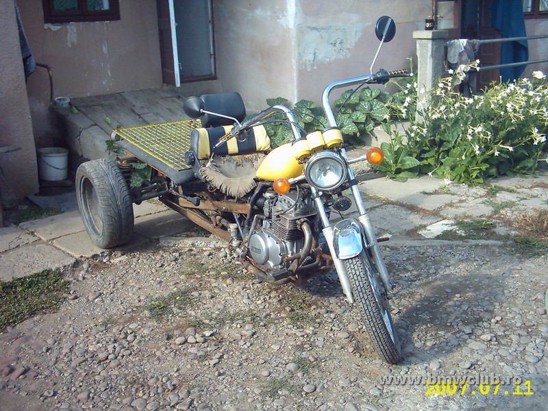

  4. Roka replied to Laur's topic in Motociclete
    nipru - 650 hornet - 600 ..yamaha trike - 400 (inca nefinalizat)
