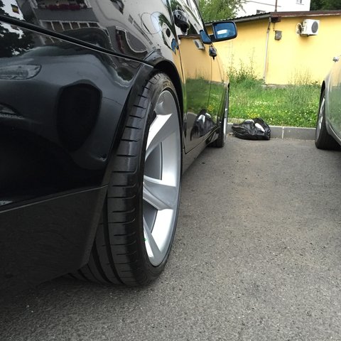

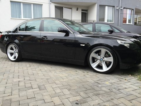

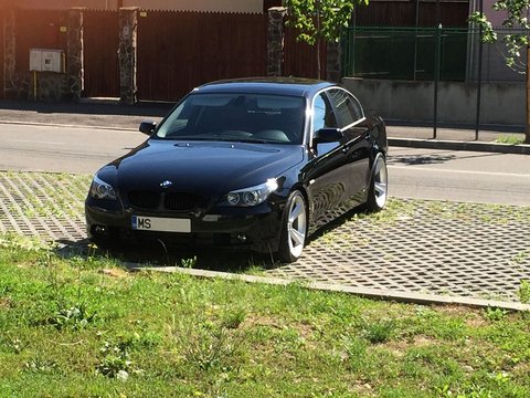

9J x 19" ET 20 Fata si 10J x 19" ET 15 Spate, nu au distantiere. 245/35 R19 XL Fata si 275/30 R19 XL - Spate Am gasit poze mai clare. http://i723.photobucket.com/albums/ww235/UnbnovvnUnknovvn/IMG_5171_zpsio2uwuzh.jpg http://i723.photobucket.com/albums/ww235/UnbnovvnUnknovvn/IMG_4715_zpsls7x8mtf.jpg http://i723.photobucket.com/albums/ww235/UnbnovvnUnknovvn/IMG_5163_zpsysig0onk.jpg http://i723.photobucket.com/albums/ww235/UnbnovvnUnknovvn/IMG_4695_zpsixynlhag.jpg http://i723.photobucket.com/albums/ww235/UnbnovvnUnknovvn/IMG_5031_zps8sh1ekrg.jpg
