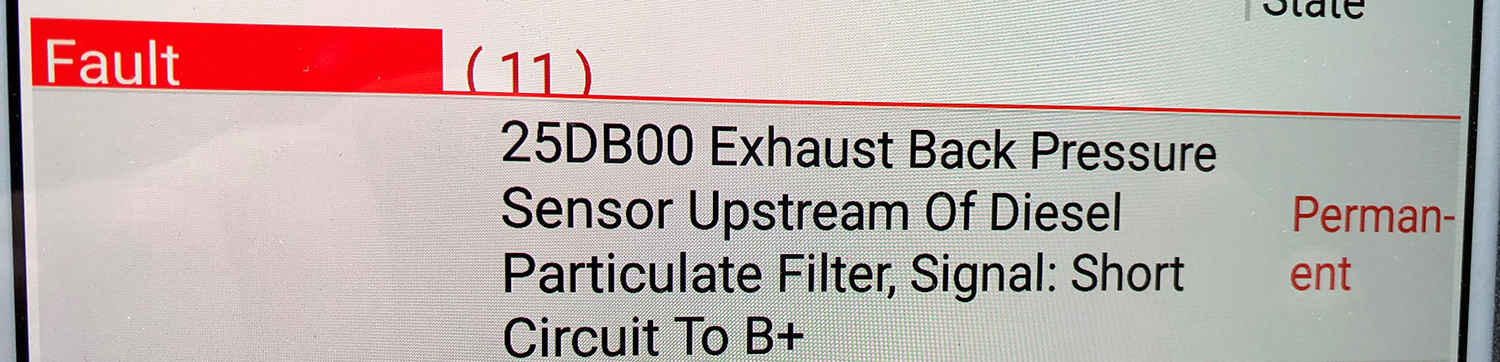

Am facut diagnoza. Se pare ca e vorba de codul 25DB00, "Exhaust back pressure sensor upstream of Diesel particulate filter, signal: short circuit to B+". E fie senzorul de presiune (part number 13627808013), fie un furtun infundat, ce merge la senzor. Am sa desfac si verific in curand :)
problema rezolvata, era un senzor (part number:13627805152, pozitia 5 aici http://www.realoem.com/bmw/en/part?id=FW11-EUR-10-2010-F10-BMW-520d&mg=13&sg=15&diagId=13_1367&q=13627805152 ). L-am schimbat singur in 3 minute, a disparut eroarea :) cost: 185 lei cu tot cu transport Edited by xavierus911
