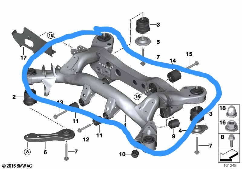

Or you are trying to say you did the alignment (tracking) of the wheels and everything is ok.. That's what your are trying to say? Has the alignment done for all wheel at the same time? It is a bit unusual that the specialist didn't pick up the reason the behicle is not straight.
...Why you didn't changed both springs? It is recommended that both side of each axle should be replaced at the same time.
What spring manufacturer did you use?
Did you look or the tracking specialist looked at all subframe bushings not being cracked or having desintegrate rubber from bushing. Has every suspension arm checked for missing parts from bushing and subframe?
It is very important to check everything with close attention.
