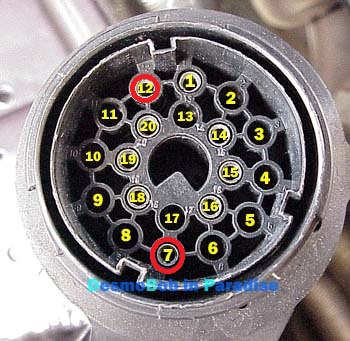

Pt E36 cu cheia in contact in pozitia 2 se face scurt intre pin 7 si - (masa) timp de 3 secunde pt oil service iar pt resetarea inspection service se tine in scurt pin 7 cu - timp de 12 sec.

Nici la mine nu merge,in schimb am reusit cu firul intre PIN-ul 7 si 19 :)

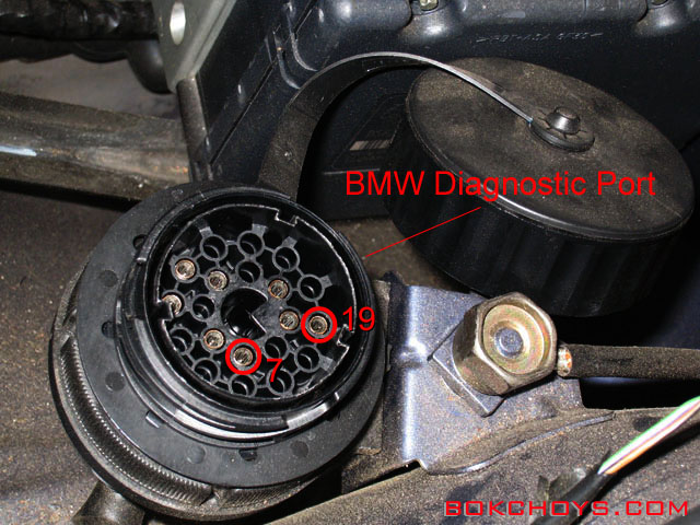

Oil Service Indicator Reset
1999-2000 E46s: You need a service internal reset tool or you can do it manually from the Diagnostic Port under the hood of the car. (Figure M)
If you don't have a reset tool, use a paper clip or wire to ground the service inspection pin.
Turn Ignition to Position 1
Oil Reset - Connect Pins 7 and 19 for 3 seconds.
Inspection Reset - Connect Pins 7 and 19 for 9 seconds.
Sursa: http://www.bokchoys.com/differential/diy_oil_change.htm
