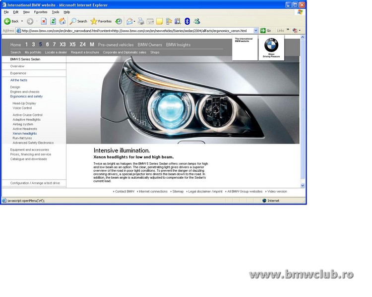

Uite aici de la BMW seria 5 din 2004.
http://www.bmw.com/com/en/newvehicles/5ser...mics_xenon.html
"Intensive illumination.
Xenon headlights for low and high beam.
Twice as bright as halogen: the BMW 5 Series Sedan offers xenon lamps for high and low beam as an option. The clear, penetrating light gives drivers a superior overview of the road in poor light conditions. To prevent the danger of dazzling oncoming drivers, a special projector lens directs the beam down to the road. In addition, the beam angle is automatically adjusted to compensate for the Sedan's current load."
Ca sa revenim la topic: bi-xenon inseamna xenon atat la faza mare cat si mica. Sau nu ?
