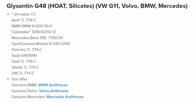

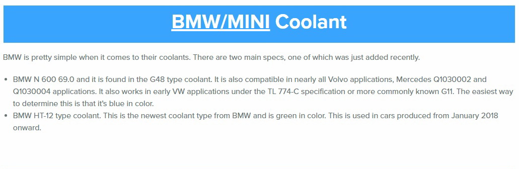

Hop si eu cu 2 poze. Poate ii ajut pe nehotarati.
Asta e norma : BMW N 600 69.0
Mai simplu, G48 sau G11 (denumire pt VAG) sau albastru.
La motoare dupa Ianuarie 2018, HT-12 verde.
Sursa : https://blog.fcpeuro.com/how-to-pick-the-right-coolant-for-your-car
Se pot invata si alte lucruri importante de acolo.
Faina asta : "BMW, Mercedes, and Volvo have been using IAT coolant since the 80’s. Now the formulation changed to a HOAT fluid. Not much has changed in the composition or the specification since. The intervals that they need to be replaced at have however been extended all the way from 2 years in the 80’s initially to 3 years to 4 years in the 90’s to now “LIFETIME” in virtually all BMW applications. Guess what is the weak spot of a modern BMW… The cooling system! We wonder why?" :) Normal, de la 2 ani la lifetime...
