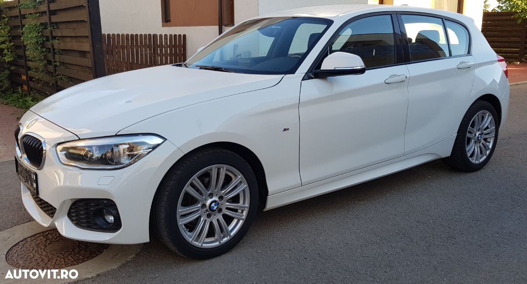

  5. Salutare, colegi! Postez un anunt pentru un prieten care nu este pe forum. Este vorba de un BMW F20 116d din 2016 / 43300km / cutie manuala. Va rog sa-l contactati pe el direct in cazul in care sunteti interesati de masina prezentata. TEL: O752.O94.127 - NICU VIN: WBA1V710705A62480 Type Code1V71 E Series F20 (MUE) Series 1 Type SH Model116D (EUR) Steering LL Doors 5 Engine B37U Displacement 1.50 Power 85 Drive HECK Transmission MECH Colour ALPINWEISS 3 (300) Upholstery STOFF HEXAGON ALCANTARA/ANTHRAZIT (HAAT) Prod. Date 2016-07-26 P337AM Sports package P7LFA Modell M Sport S1CAASelection of COP relevant vehicles S1CBACO2 package S216AHydro steering-servotronic S225AStandard suspension S230AExtra package, EU-specific S249AMultifunction f steering wheel S258ATire with run-flat functionality S2N3ABMW LA wheel M Star Spoke 383 S2PAAWheel bolt retainer S2VBATire pressure display S423AFloor mats, velours S428AWarning triangle and first aid kit S431AInterior mirror with automatic-dip S465AThrough-loading system S481ASports seat S493AStorage compartment package S4AEAArmrest front, retractable S4WFAAlu, hexagon, matt blue accent S502AHeadlight cleaning system S508APark Distance Control (PDC) S521ARain sensor S534AAutomatic air conditioning S544ACruise control with brake function S548AKilometer-calibrated speedometer S563ALight package S575ASupplementary 12V sockets S5A1ALED Fog lights S5A2ALED headlight S5DAAPassenger airbag deactivation S5DCARear-seat headrests, folding S663ARadio BMW Professional S698AArea-Code 2 for DVD S6ACAIntelligent emergency SOS call S6AEATeleservices S6NHAHands-free with USB interface S6WAAInstrument cluster, expanded equipment S6WAAInstrument cluster, expanded equipment S710AM leather steering wheel S715AM Aerodynamics package S760AHigh gloss shadow line S775AHeadlining anthracite S7CGABMW Repair Inclusive S7NHABMW Service Inclusive S8A6ALanguage version 'Slovenian' S8AVAOn-board vehicle literature Slovenian S8KAADummy-SALAPA S8R9ARefrigerant R1234yf S9AAAOuter skin protection Servicii & Garantie Service Inclusive - 5 ani/100.000 km pana in data de 27.07.2020 (include proceduri de service Âşi ĂŽntreĂžinere: schimbarea uleiului de motor, inclusiv a filtrului, service / ĂŽnlocuirea filtrului de aer, a microfiltrului, a bujiilor Âşi a lichidului de frânĂŁ, verificarea Âşi revizia standard a vehiculului Repair Inclusive - 3 ani/200.000 km – garantie producator pana in 27.07.2020. PRET: 15800Euro / negociabil Pentru mai multe poze va pot trimite link pe mesaj privat. Va multumesc!
