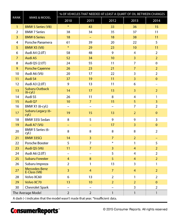

Studiu privind consumul a unui "quart" de ulei intre intervalele de service, facut pe aprox. 500.000 de masini.
P.S. 1 quart = 1,13 litri ulei
Sursa: https://www.consumerreports.org/cro/magazine/2015/06/excessive-oil-consumption/index.htm
Mai adaug cateva informatiile aditionale, specifice motoarelor BMW.
Scuze ptr ca nu am facut traducerea, dar cred ca este usor de inteles.
BMW attributes oil top-up frequency to the luxury vehicles’ long intervals between oil changes -- 10,000 miles -- and BMW engines may consume up to 1 quart of engine oil per 750 miles under certain driving conditions
The traditional oil-change frequency recommendation is every 3,000 miles, but fine-tuning in engine manufacturing and oil technology has led some automakers to extend that to 7,500-10,000 miles.
“Oil consumption is normal on all engines as it is necessary to properly lubricate the cylinder walls, pistons, piston rings, valves and turbochargers,” BMW spokesman Hector Arellano-Belloc wrote in an email.
Sursa:http://www.autonews.com/article/20150630/RETAIL05/150639990/newer-audi-bmw-subaru-models-use-lots-of-oil-consumer-reports-survey

Mda ... Consumul de ulei este in functie de motorizare/uzura/exploatare si tipul de ulei folosit, nu in functie de masina ... Acolo zice de seria 7 si seria 6 care au procente diferite , sa inteleg ca daca masinile alea au acelasi motor consumul de ulei o sa fie asa de diferit ? :D
PS: Testul este facut in SUA si prin urmare cred ca este vorba mai mult de benzinare, care se stie ca sunt mai mancacioase...
PS2: Nici la Mercedes si nici la BMW care sunt toate cu motor de 3l diesel nu am vazut diferenta de nivel pe joja de ulei intre schimburi , la C class care este benzinar am vazut o dferenta dar nu a necesitat sa completez intre schimburi (nici nu prea a iesit masina din oras)
