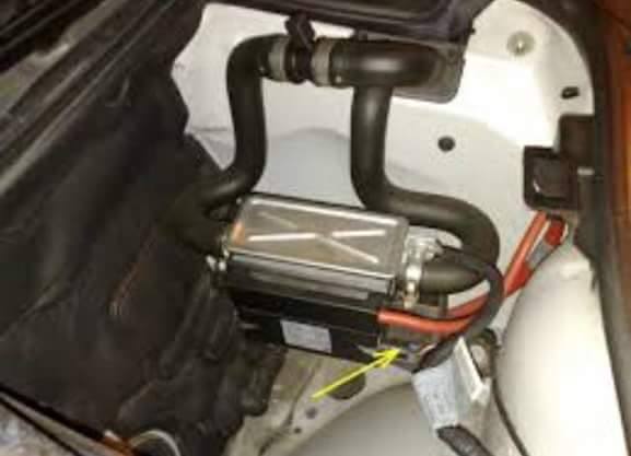

Salut!Am avut si eu vibratiile la rece de care vorbiti. La mine respunsabil a fost electric auxiliar heater, adica cutia de inox din spatele farului de la sofer. Puteti verifica simplu asta in momentul oscilariilor scotand mufa mica de la aceasta.

Salut ar avea o logica ce spui...am gasit cum functioneaza circuitul...

Electric Auxiliary Heater DDE 3.0 (E46 only)
The electric auxiliary heater heats the coolant with electric heating elements to compensate for the slight heat loss at high degrees of engine efficiency. Depending on the vehicle equipment, the heating request is sent either from the air conditioning system (IHKA) or from the heating control to the DDE control unit.
The heating elements only cut in only when there are sufficient electrical power reserves. To determine the available power reserves, the alternator sends a pulse duty factor signal corresponding to the current alternator load to the DDE control unit. Depending on the permitted additional alternator load, the DDE control unit activates the auxiliary heater with a square-wave signal with pulse duty factors (= variable pulse width) between 5 and 95 % thus controlling various heating power stages.
The idle speed is increased to 930 rpm when the auxiliary heater is activated.
I thought the auxillary heater was to speed up heating of the engine coolant in cold conditions & light load conditions.
Poti sa fii sigur ca are. Cand porneste electric auxiliar heating creste relantiul, daca nu reuseste sa porneasca tot ai oscilatiile de care vorbiti.
Pe scurt scoate-i mufa mica si vezi daca mai oscileaza relantiul.

Am schimbat azi si heater=ul.Dupa ce I am dat cheie...relantiul a crescut la 780rpm in conditiile in care imi statea iarna vara la 730.Numai clipesc luminile de fructuat fff putin probabil pana se invata calculatorul.Dimineata ar trebui sa urce relantiul la 1100rpm si sa coboare pe masura ce se incalzeste...

Am pornit dimineata motorul...relantiul a urcat pana la 790rpm de la 730 cum sta normal.totusi la ce frig ce efara trebuia sa urce la 900 -1100.am sa incerc si alt heater posibil asta sa nu mearga la toti parametric lui!
Nu e de la heater, el iti urca turatia cu maxim 100 rot/ min cand e cuplat. Tie nu iti intra socul cand e frig, a mea se tureaza pana la 1100 dupa care revine treptat pana 850-900 si incepe sa balbaie...
