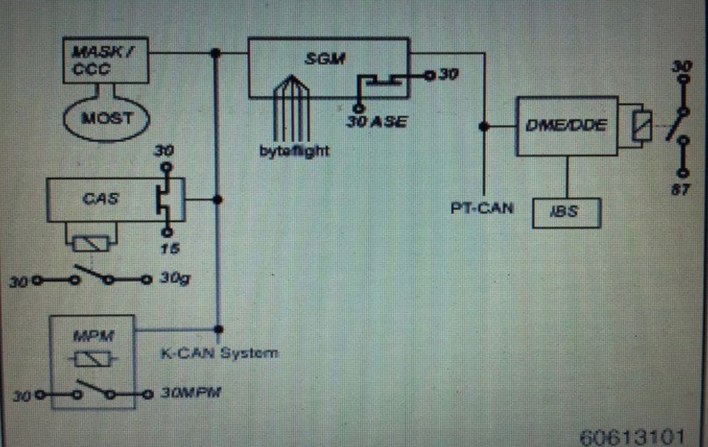

Am și specificat sa ma contacteze băiatul sa ii explic cum sa procedeze eu nu stau sa pun filmări și sa comentez aiurea in necunoștință de cauza cum procedezi tu …ca la o problema de genul in afara de ibs habar nu aveți de la ce poate fii măcar problema , nu stau sa ma cert cu nimeni și nu stau sa îți dau ți-e explicați ca am observat cât sti și tu sunteți plini de teorie  va cam omoară practica 😉 de la poza atașata poate sa înceapă căutările ce calculator ii rămâne treaz ala ii mănâncă bateria .
E60 Battery Measurement Explained:
The wiring diagram to the right shows briefly the main modules controlling power supply on the car. When the car is switched off each module goes into
“sleep mode “ after a length of time that is programmed in the factory. Generally all modules are asleep in 45 minutes after vehicle switch off. When this happens the battery state of health is then measured by the IBS
(Intelligent battery Sensor). This is a electronic component connected to the negative
battery terminal. The IBS is programmed to “wake up” every 14 seconds so that it can update the measured values with the new measurements. The measuring time is approx. 50 milliseconds. When the engine is restarted the engine ECY DME then reads the stored data from the IBS sensor and compares the current consumption with the pre-programmed acceptable value. If con- sumption is out side the accepted range then a fault code is stored in the ECU/DME
Pune mâna și documentează-te. Înainte sa vorbești ca pui oameni sa schimbe piese bune cum fac majoritatea. De 8 ani toate BMW care le-am avut nu au călcat in servis indiferent de problema prietene 🥲🙃
To test this the only option is to use an amp meter connecting in series with the negative battery terminal. When this was done a drain of 250 milliamps after 1 hour( to allow the car to go to sleep mode) was found. The acceptable drain for this should be below 15milliamps. To narrow down where this drain was coming from we had to start removing fuses one by one. This is a time consuming procedure but unfortunately the only way to find the fault. When fuse number 57 Was re- moved we found that the drain dropped to approx 10 milliamps . On consulting the fuse function this fuse supplied the MPM ( Micro Power Module). A small module in the boot floor under the spare wheel which controls the power supply to the au- dio and navigation systems. We then consulted the wiring diagram for this module and carefully checked all power supplies and outputs from the module and it was found the module wasn't “ shutting down” correctly

Asa, nu mai sta pe aici, ca, daca punem intrebari...
Trebuie sa ia schema asta si sa se uite bine la ea si sa te contacteze pe privat obligatoriu..
Eu chiar vorbesc serios. Este o schema bloc interesanta. E bine ca macar a ta e reparata.
S-a inteles tot. Primul text e din TIS copiat iar al doilea e de pe vreun forum englez.. american.. sau un pdf cum e atasat mai jos
